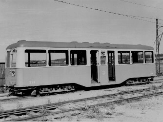

SS B11 (II)
AB Stockholms Spårvägar class B11 (II) no 519-558
"två-rum-och-kök"
© Stockholms Spårvägsmuseum
| data for the class B11 (II) "två-rum-och-kök" | |
| Vehicle: | trailer car, boggie |
| Class: | 4-axled double-ended (4xZR) |
| Town: | Stockholm |
| Class: | B11 (II) "två-rum-och-kök" |
| Car number: | 519-558 |
| Built number: | 40 |
| Manufacturer: | ASEA, ASJ, Maskinverken 1937 |
| Staffing: | rörlig konduktör |
| Gauage (mm): | 1435 |
| Length (mm): | 12550 |
| Width (mm): | 2330 |
| Height (mm): | 3040 |
| Weight (kg): | 10900 |
| Axel arrangement: | 2'2' |
| Wheelbase (mm): | 1500+5230 |
| Boggie center base (mm): | 6730 |
| Wheel diameter (mm): | 600 |
| Wheel tread width (mm): | 100 |
| Type of motor: | |
| Motor power (kW): | |
| Type of controller: | |
| Type of coupling: | albert |
| Compressor: | |
| Operating current: | |
| Max speed (km/h): | |
| Door arrangement: | VH 0-020-0 |
| Number of passengers: | 42 seating + 32 standing = 74 passengers |
| Out of service: | |
| Note: | fd B22 |
"Två-rum-och-kök", före 1949 littera B22.
Leverantörer: nr 519-538 ASEA, nr 539-550 ASJ, nr 551-558 Sv. Maskinverken.
Bevarad vagn: nr 521 på Djurgårdslinjen.
