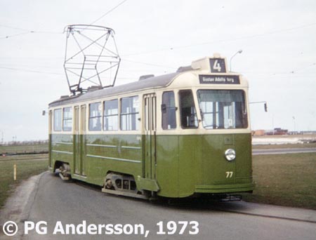

MSS G
Malmö Stads Spårvägar class G no 70-81
"mustang"
G
© PG Andersson
data for the class G "mustang"
