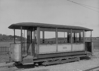

SS B13
AB Stockholms Spårvägar class B13 no 628-632
© Stockholms Spårvägsmuseum
data for the class B13 | |
Vehicle: | trailer car |
Class: | |
Town: | Stockholm |
Class: | B13 |
Car number: | 628-632 |
Built number: | 5 |
Manufacturer: | Ringvägen 1914 |
Gauage (mm): | 1435 |
Length (mm): | 7400 |
Width (mm): | 2270 |
Height (mm): | 3030 |
Weight (kg): | 4800 |
Axel arrangement: | 2 |
Wheelbase (mm): | 1800 |
Boggie center base (mm): | |
Wheel diameter (mm): | 760 |
Wheel tread width (mm): | |
Type of motor: | |
Motor power (kW): | |
Type of controller: | |
Type of coupling: | |
Compressor: | |
Operating current: | |
Max speed (km/h): | |
Door arrangement: | |
Number of passengers: | 18 seating + 21 standing = 39 passengers |
Out of service: | ![]() |
Note: | fd SSB BC4 |
Tidigare SSB BC4 nr 181-185, öppna sidor sommartid.
Bevarad vagn: nr 629 som SSB BC4 nr 182 på Museispårvägen i Malmköping.
