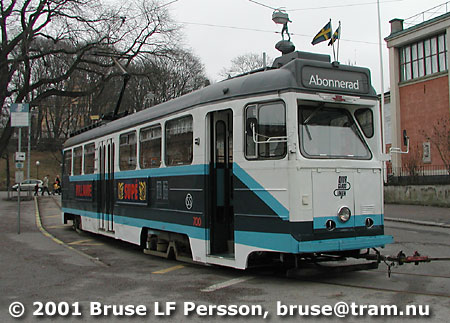

SS(2) A33
AB Stockholms Spårvägar class A33 no 700
"Høka"
| data for the class A33 "Høka" | |
| Vehicle: | motor car, boggie |
| Company: | AB Stockholms Spårvägar (SS(2)) |
| Town: | Stockholm |
| Class: | A33 "Høka" |
| Car number: | 700 |
| Built number: | 49 |
| Manufacturer: | Høka, Hägglund 1952-1958 |
| Staffing: | fast konduktör |
| Gauage (mm): | 1435 |
| Length (mm): | 14700 |
| Width (mm): | 2500 |
| Height (mm): | 3110 |
| Weight (kg): | 16900 |
| Axel arrangement: | |
| Wheelbase (mm): | 1800 |
| Boggie center base (mm): | 7600 |
| Wheel diameter (mm): | 680 |
| Wheel tread width (mm): | 110 |
| Type of motor: | Hägglund MBL10 |
| Motor power (kW): | 4x45,6 |
| Type of controller: | Hägglund & Söner CBKM-4A, kamvals |
| Type of coupling: | albert |
| Compressor: | Atlas-Copco NE3 |
| Operating current: | 600 V DC |
| Max speed (km/h): | |
| Door arrangement: | H 1-0-20-1 |
| Number of passengers: | 36 seating + 100 standing = 136 passengers |
| Out of service: | |
| Note: | |
Fd OS "Höka" litt MBO56 (SM53) nr 249, användes som Partyvagn på Djurgårdslinjen - fd SS A3 nr 700.
MBO50 nr 204-233 levererade 1952-1953.
MBO55 nr 234-245 levererade 1957.
MBO56 nr 246-253 levererade 1958.
MBO50 levererades med 41 sittplatser, ändrat till 36 i 1959.
