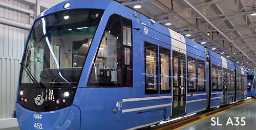

SL A35
AB Storstockholms Lokaltrafik class A35 no 451-493
A35
data for the class A35
Vehicle:  motor car
Class:  8-axled articulated single-ended partially low-floor (8xGelER NfT)
Company:  AB Storstockholms Lokaltrafik (SL) nytt fönster
Town:  Stockholm
Line:  Tvärbanan
Class:  A35
Car number:  451-493
Built number:  43
Manufacturer:  CAF 2013-2014
Gauage (mm):  1435
Length (mm):  30800
Width (mm):  2650
Height (mm):  3633
Weight (kg):  51000
Axel arrangement:  Bo'Bo'Bo'Bo'
Wheelbase (mm):
Boggie center base (mm):  9600
Wheel diameter (mm):  630/550
Wheel tread width (mm):
Type of motor: ABB 4RBA2744
Motor power (kW):  8x70
Type of controller:
Type of coupling:
Compressor:
Operating current:  750 DC
Max speed (km/h):  90
Door arrangement:
Number of passengers:  72 seating + 143 standing = 215 passengers
Out of service:
Note:  CAF Urbos AXL
Första leveransen var på 15 vagnar, därutöver har 7 vagnar leveretats som A36 (10 m längre) för Lidingöbanan. Det finns en kvarvarande option på 99 vagnar. Totalt omfattade beställningen till CAF 121 vagnar.
451-465 (A35 serie 1)
466-473 (A35B)
474-483 (A35 serie 2)
484-493 (A35 serie 3)
