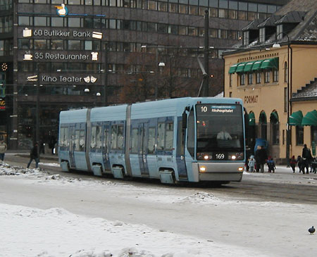

OS SL95
AS Oslo Sporveier class SL95 no 141-172
© Andreas Tunem Arnestad
| data for the class SL95 | |
| Vehicle: | motor car |
| Class: | 8-axled articulated single-ended partially low-floor (8xGelER NfT) |
| Company: | AS Oslo Sporveier (OS) |
| Town: | Oslo |
| Class: | SL95 |
| Car number: | 141-172 |
| Built number: | 32 |
| Manufacturer: | Ansaldo, Firema 1998-2000 |
| Gauage (mm): | 1435 |
| Length (mm): | 33120 |
| Width (mm): | 2600 |
| Height (mm): | |
| Weight (kg): | 64980 |
| Axel arrangement: | Bo`Bo`Bo`Bo |
| Wheelbase (mm): | 855+5170+ 9855 |
| Wheel diameter (mm): | 680 |
| Wheel tread width (mm): | |
| Type of motor: | |
| Motor power (kW): | 840 |
| Type of controller: | |
| Type of coupling: | |
| Compressor: | |
| Operating current: | 750 V DC |
| Max speed (km/h): | 80 |
| Door arrangement: | |
| Number of passengers: | 88 seating + 108 standing = 196 passengers |
| Out of service: | |
| Note: | |
